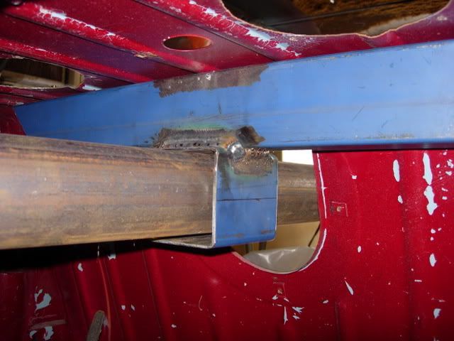

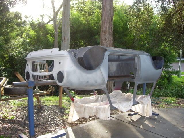

hey dave where did you get your rotisserie from?
Made it Josh. About $250 from memory. A little modified since these pictures were taken - now has pin locks for different positions.
Back under the house since the car is almost complete - so if you need to borrow?
