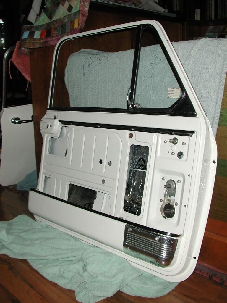

Almost at the point of putting the guts back into my doors (too hot to work in the garage.......), wondering what the best order to do this is? I'm thinking:
1) Lock/remote handle/Door handle
2) 1/4 vent window
3) winder mechanism
4) drop glass
Does that sound right?

I think it is more like 1, 3, 4, 2

Thanks Steve, the winder will hold the drop glass enough while the 1/4 vent goes in?. Just don't want to scratch the nice new paint.

Not sure about the other bit's but the 1/4 vent has to go in after the drop window or the drop window won't fit in . It has to tilt forward to get in and is secured by the 1/4 vent .

You cant put the glass in last, it needs to be in place before the 1/4 glass goes in. While putting the 1/4 glass in you put the window glass into the channel on the 1/4 glass frame. If the 1/4 glass is installed first you can't fit the window glass.

I think this is going to be one of those jobs where one side takes all morning and the other side 30mins! Will try 1,3,4,2 and see how I get on, will report back.
One more question, one of the doors had a wooden block in the bottom. I think it was to stop the drop glass going too far down, is that a common problem? Looks like there are stops on the winder mechanism gear. I'm thinking perhaps there was too much play between the drop glass and the 1/4 vent window channel, allowing the drop glass to rotate at the bottom of its travel and make it difficult to wind back up?

watch out you don't scrape your nice new paint on the inside top frame of the door when inserting the 1/4 vent.

I also re-assembled my doors right after having the car/ doors painted, and I generously applied painters tape in 2 or 3 layers to the door frame before putting in the wing windows. They do rub the doors, so this will save your paint.

Thanks fore the help Guys, 1342 did the trick - here is the order I used as per your suggestions:
Door lock U-bracket with connecting rod already attached
Inside door opener handle mechanism
Outer door handle
Lock mechanism
Bailey channel felt
Window winder machanism
Drop glass
1/4 window assembly.
