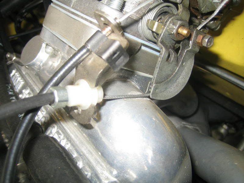

PostPosted: Wed Aug 11, 2010 3:35 am
Posts: 460
As Kevin suggests mill the spacer thinner...which is what I did and round filed the Mini Spares intake to allow the throttle quadrant to rotate without fear of interference.
