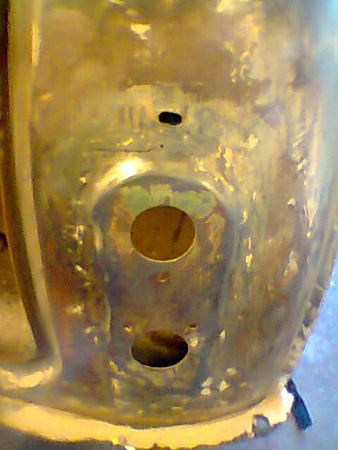

Should I weld up this hole above the drivers side rear light or is it for something?
thanks
frank
Roundy Sedan project with/for daughter
PostPosted: Mon Feb 25, 2013 12:09 am
Joined: Mon Feb 20, 2006 2:32 am
Posts: 610
Location: Parmelia, WA
weld it up. its not meant to be there

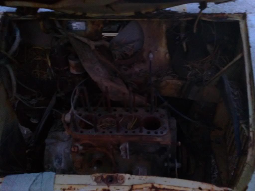

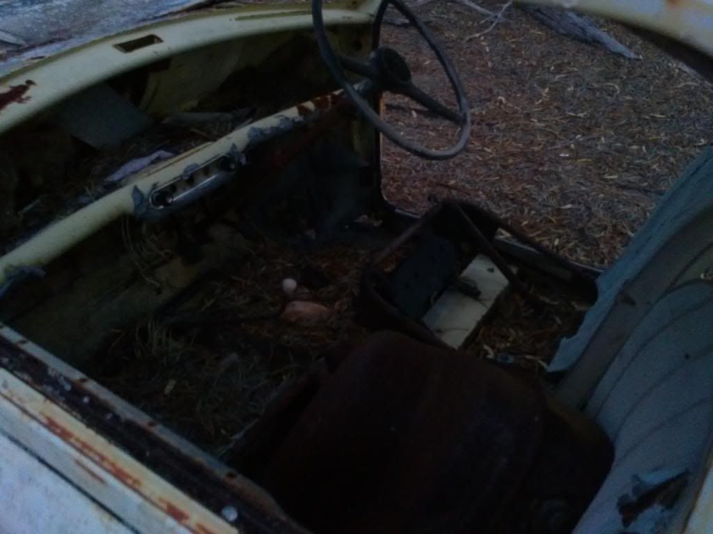

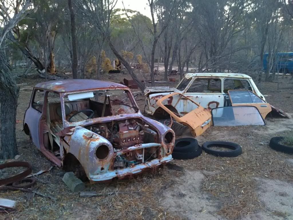

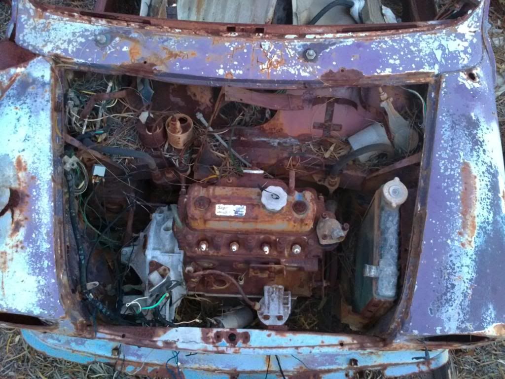

there are two minis dumped on the farm
apart from the missing stuff I don't have is there any other parts that I should grab off them that is potentially going to be useful?
PostPosted: Sun Mar 10, 2013 12:16 am
Check the numbers on the head (somewhere between the valves or near the thermostat), block and gearboxes (behind the oil filter). The subframes and suspension components can be useful, wiper motors, check the numbers on the bodies mainly the straight one just to see what they actually are. The seat frames may be worth something but by the looks of it theirs not much more left on the shells.
From the looks of it the yellow/white one looks like an 850 so if the doors aren't too bad they could be worth some cash (good ones go for $200 each).
The red shell if it's not to rusty could be worth saving or selling aswell.
