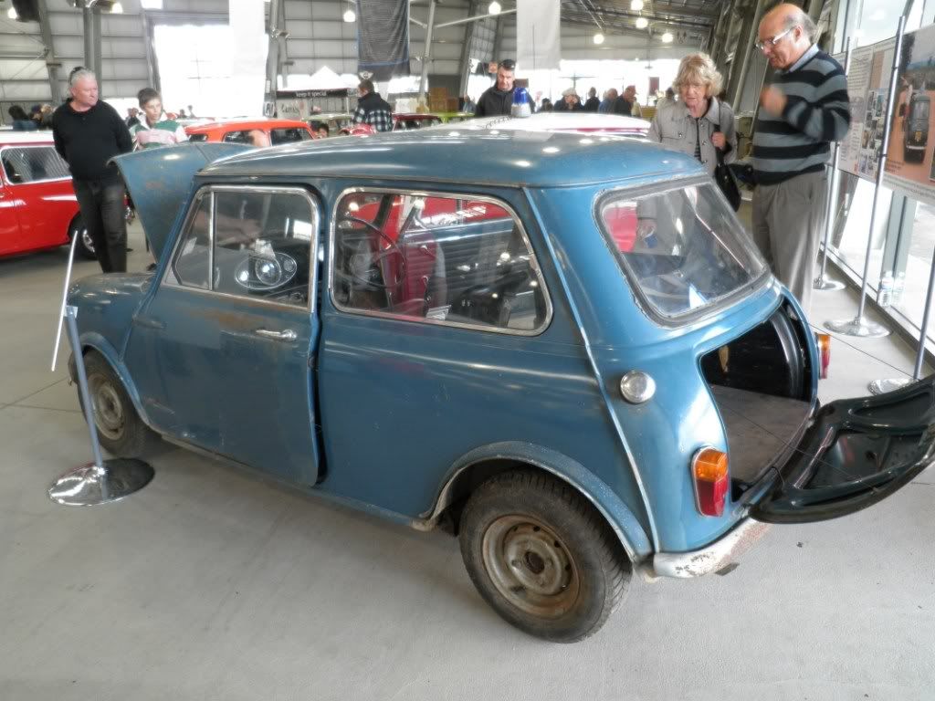

I think Winabbey's Police Cooper is Baltic blue...nice colour!

Lovely colour, very sweet 8)
