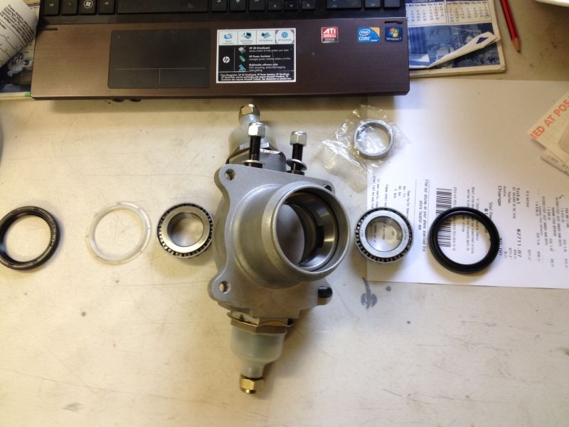

I finally received these yesterday but l am concerned that l may build these wrong, from left to right in the pic is this right, and what's the fat washer for in the bag?

Check this out in the how to section it is for a drum to disc conversion but includes assembling the hubs. Might help

The clear plastic thing is a dust seal that goes on outside of the inner seal. The fat washer is the spacer shim that goes between the 2 bearings inside the hub.

If you are having issues, getting the bearings in, stick it on a cook-top.

I thought the white thing was a seal spacer to stop the rotating bearing contacting the seal! Was I mistaken ?

You are mistaken, boomini is right. :)
The white plastic guy is a dust seal, off all those parts, it will be the closest thing to the diff.

The white plastic thing is a water/slush excluder, as said it goes against the CV body, and sits in the grooved seal.
It is a UK thing, all Oz Minis just had 2 normal seals the same as the outer one shown.
