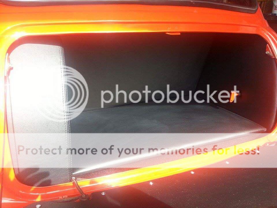

Not sure if this is what your after but here is my boot for ideas if you like.
it started as a kit from minisport.com.au but I customed it to my liking.

Yes that's exactly it. What does the sides look like? They look squared at the bottom
yes they are Squared at the bottom.
this is how it started out before I modified it to fit better http://minisport.com.au/mini-full-boot- ... tank-minis
I will be making another one in the Christmas break and happy to make a cardboard template if you can wait that long.
