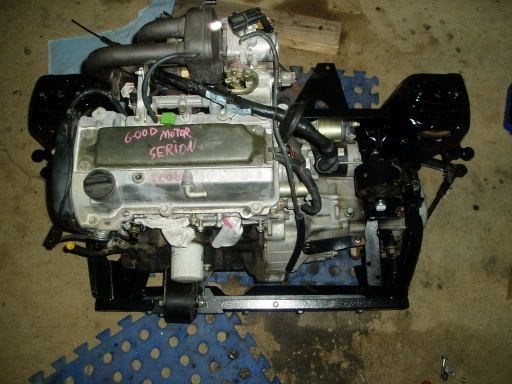

here is a pic from above to show how compact my motor is 8)
it would fit in a roundie with front mounted radiator :D

PostPosted: Tue Mar 21, 2006 11:18 pm
Posts: 966
see and its a good motor - the engine itself says so

If you are wondering about the engine I used here is a little info.
Donor 1988 Suzuki Forsa Turbo
Cylinders 3
Valves 6
Displacement 1.0l (993 cc)
Horsepower 70hp @5100rpm
Torque 107 ft.lbs @3500 rpm
Compression 8.3:1
Fuel System EPI - Multi point electronic petrol injection (MPI)
Turbocharger Spec RHB32 Parts 3T501 with intercooler
Gearbox 5 speed manual
My particular donor did not have a/c but it was available on others. 150 hp is possible without going to crazy. 200+ is possible with some major mods.
I converted the cable operated clutch to use the stock Mini master cylinder and slave cylinder.
Hope this helps, if you have any more questions I'd be happy to answer them if I can.
