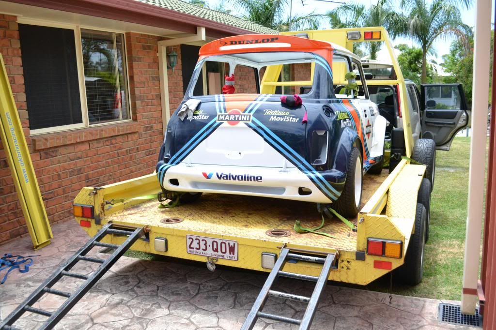

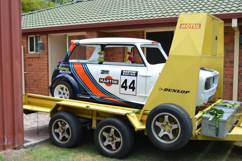

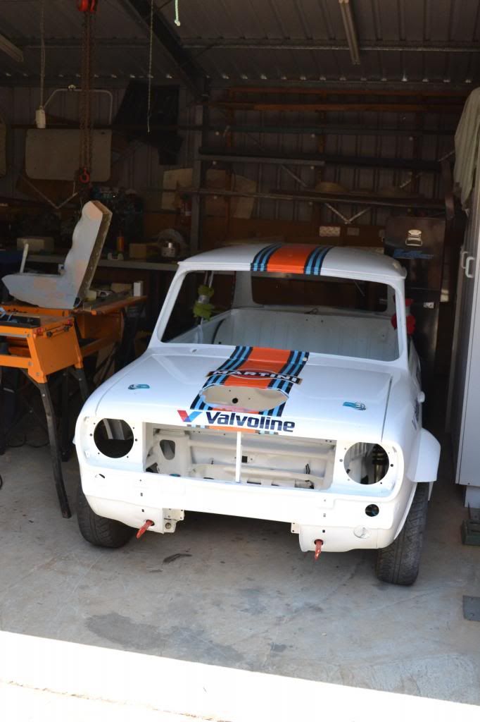

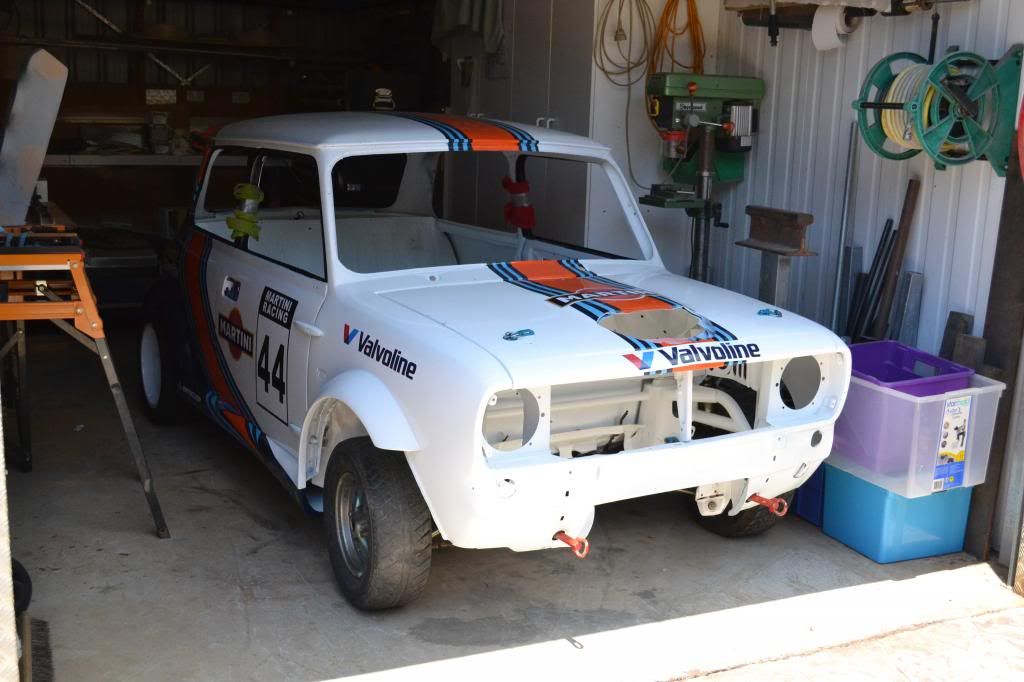

Anyway, after 3 days, 4069km, a couple hours sleep and lots of fast food, El Gato finally arrived home....
And here he is safe and sound in the shed, ready to undergo his rebuild in earnest - no mucking around now!!
I would just like to say a big, big, huge, massive thanks to Ashie and Hallsey, not only for putting Mitch and I up for a night, but for all the hard work they have done to get The Cat to where he is now - I owe you guys!! Also, thanks to all for the very kind words from you guys, it is very heartening to know your peers think that what you do is good work!!
Simon - I hope thats 99% hot and 1% sh!t!!

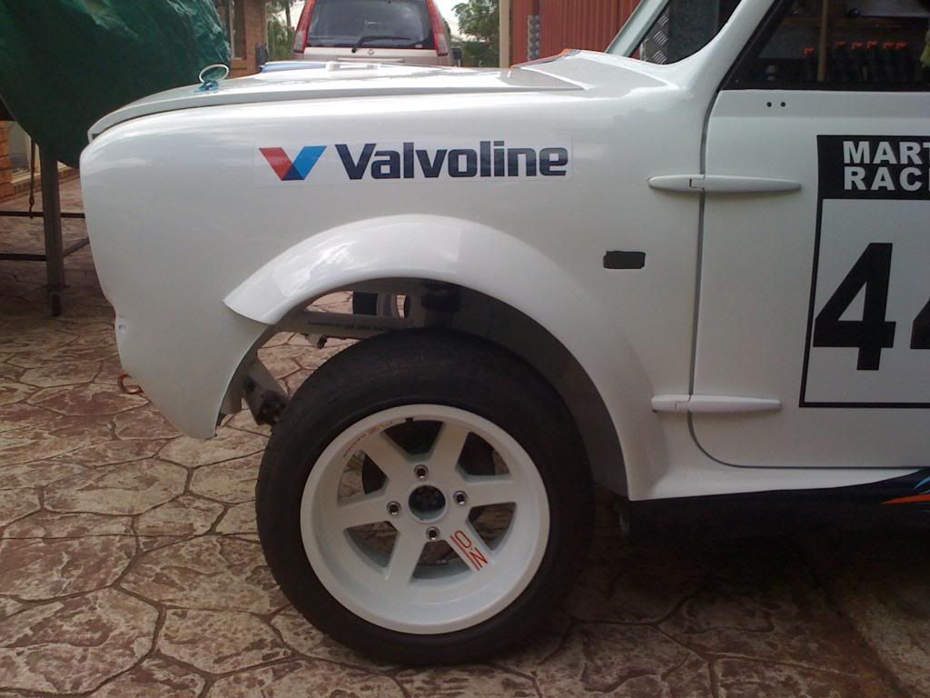

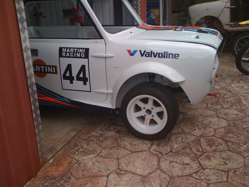

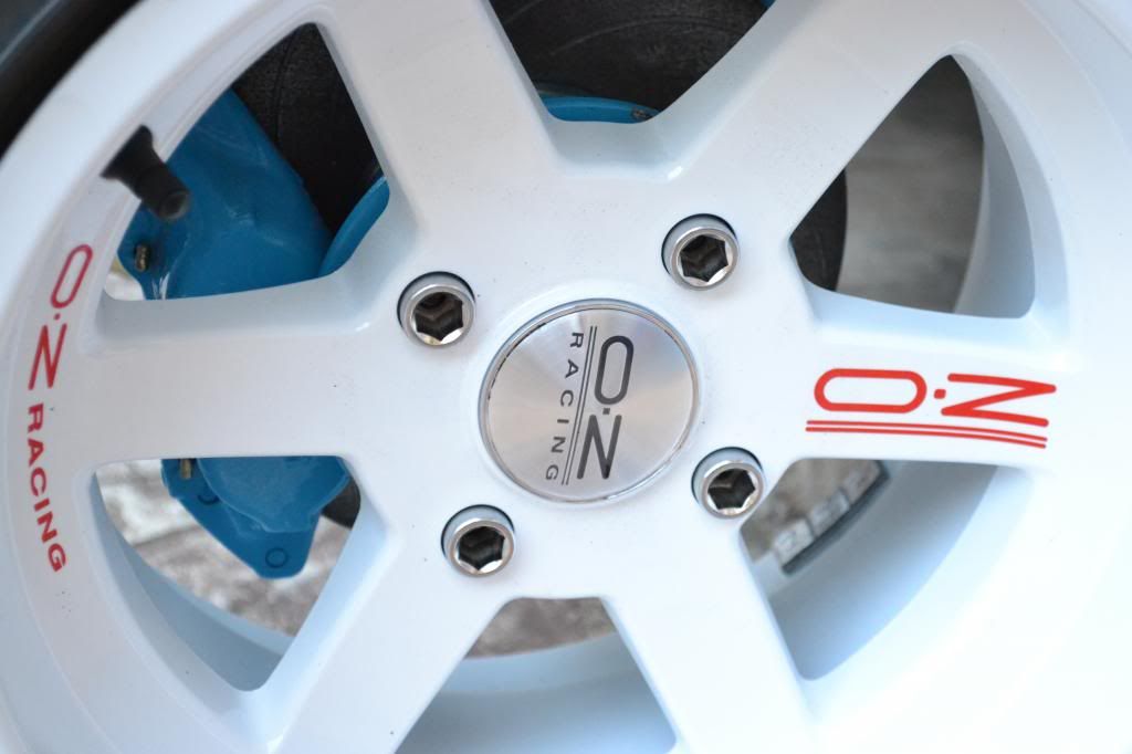

Did a bit of work today - had to machine down the centre locating rings on the drive flanges - I had already done this once (metro drive flanges) to suit the Superheavies (Superlites) but had to machine more off them off to fit the Oz Racing wheels - why arent things standard size I will never know!! So, I chucked them on the lathe and removed the rings altogether - the wheelnuts are self-centering so the locating rings are redundent.So now all the wheels are on (and that also explains why they werent on for the trip home - I didnt see that one coming!!

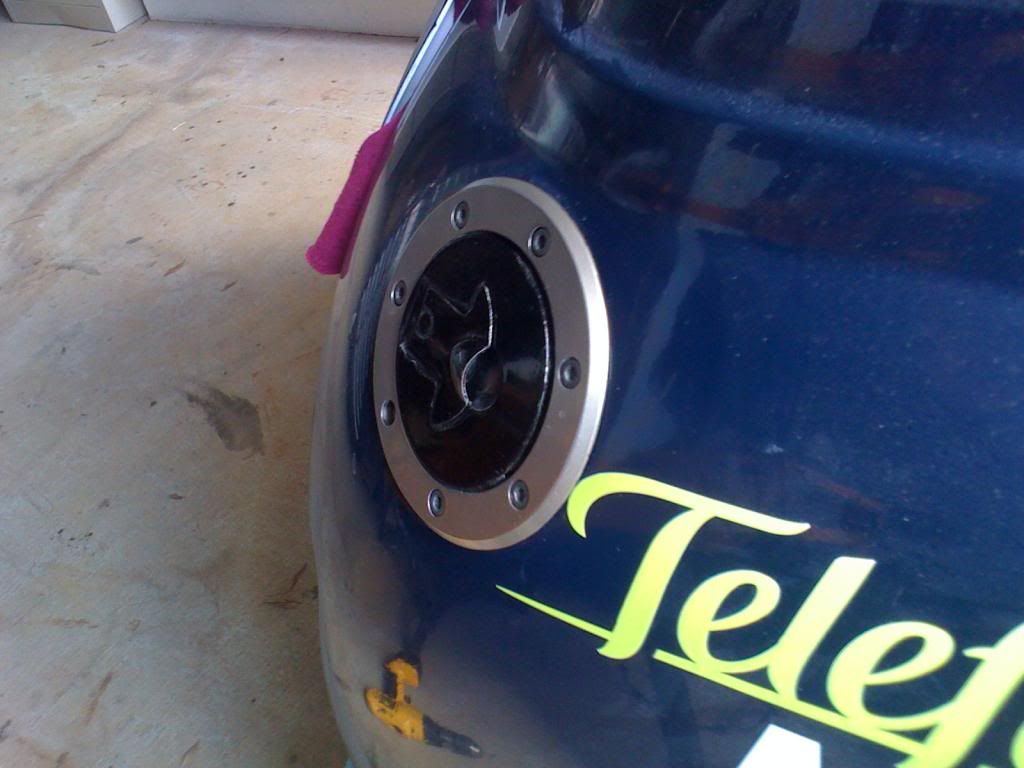

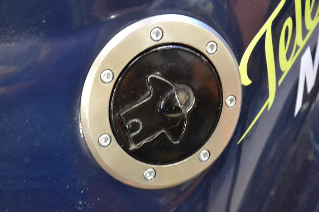

Then I fitted the hood scoop and the rubber apron that will feed the oil cooler. After that I fitted the motorcycle filler caps - mmm, flush!!!
That was it for today - had some honey-do's that had to get done. Should have the engine in soon.

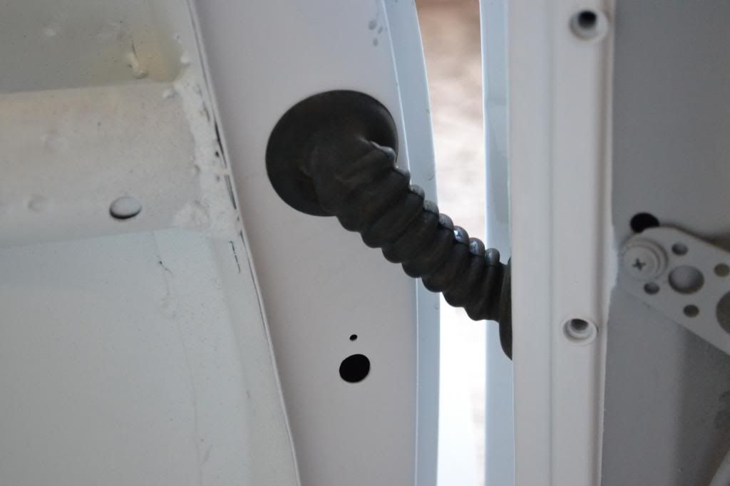

Anyway, I was dying to see how the Ford rubber door cable-ways would fit in the door gap, and whether they would interfere with the door closing - happy to report that they fit exceptionally well, and no interference with the door closing or opening. Now I can get all my speaker, central locking, courtesy light and fast glass cables into the door hidden and protected!!

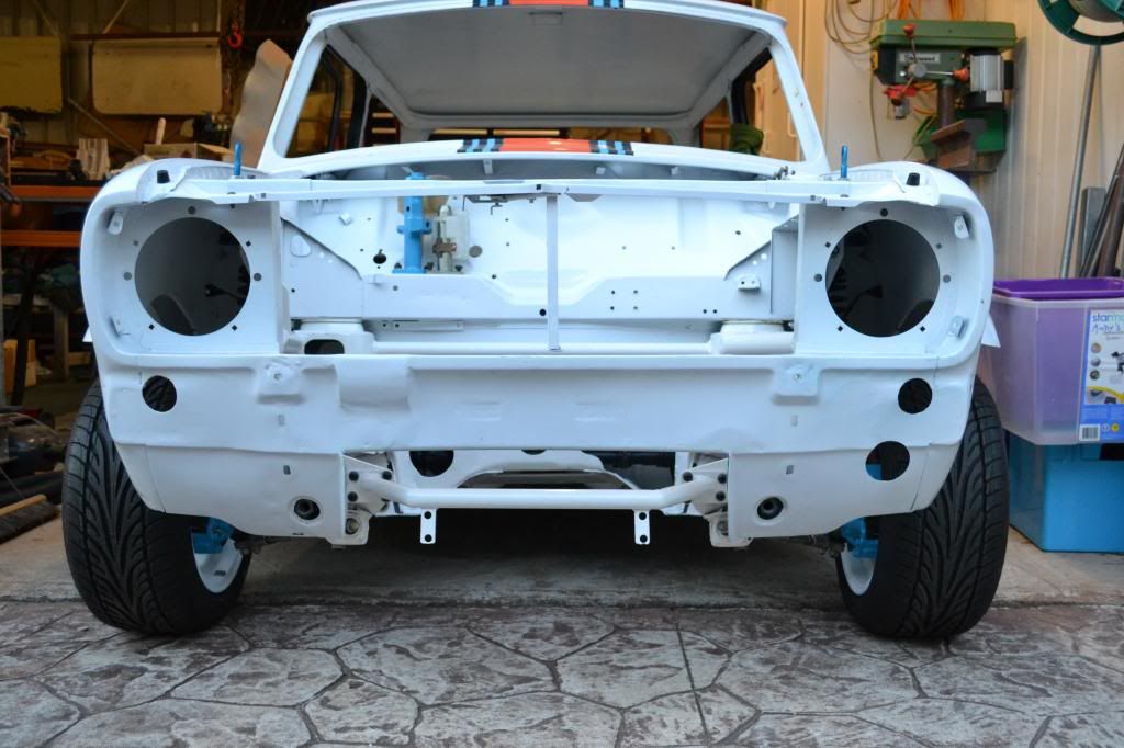

Front brakes now on for good, and centre-caps on:
Replaced the black socket-head bolts with stainless ones, as the black ones were showing signs of corrosion and not looking perfect - deliberated over this for a while - black or stainless - your choice!!!:
Subfame and front link bar in for the last time - replaced the under-floor wing bolts with stainless items to resist corrosion. Finished with the hood scoop (needed some 6mm plastic plugs, so went to Masters. Masters is the bomb, they have everything!!) so the bonnet was removed ready for the engine install:

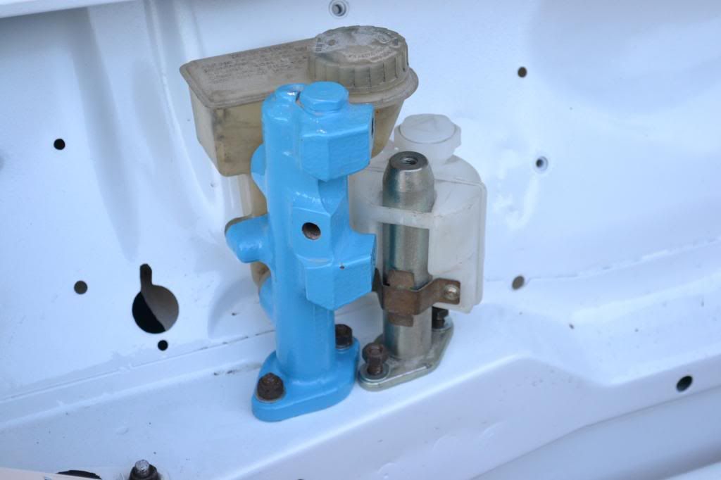

And finally, installed the pedal box and master cylinders, but will have to replace the bolts with new ones as they are rusted and look shite!!

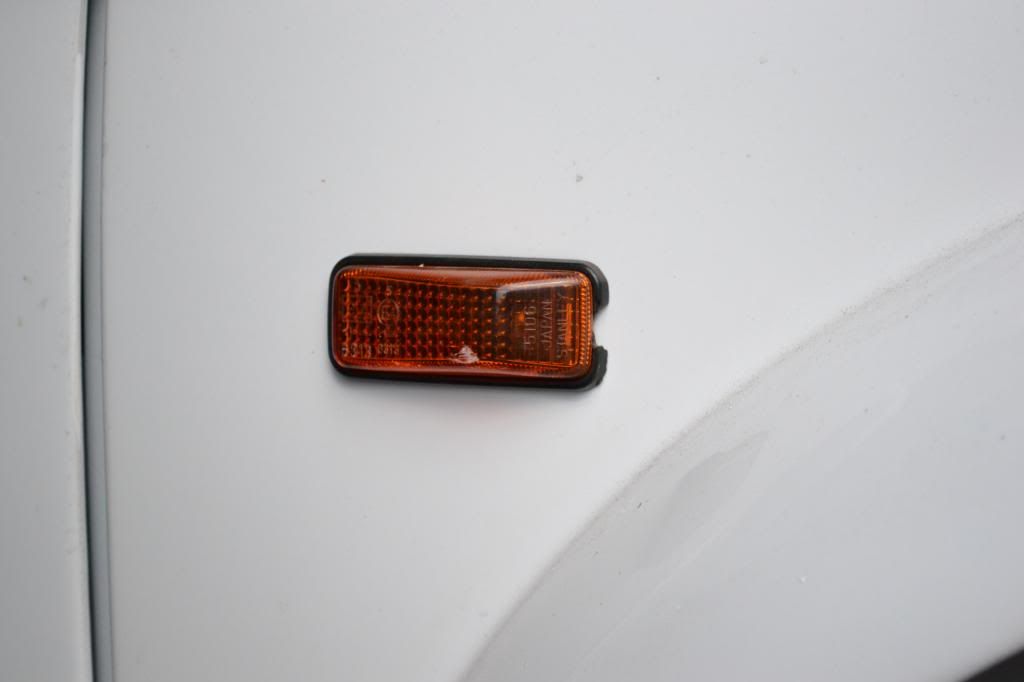

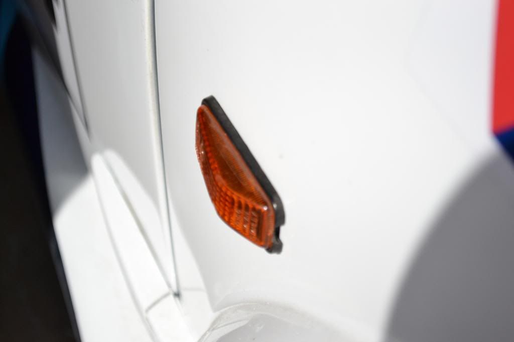

Oh, and one more, minor, but aesthetically pleasing addition, the side indicators.
Installed them yesterday, and they give El Gato a nice modern look, which is of course what we are trying to achieve. I like the shape of them too!!

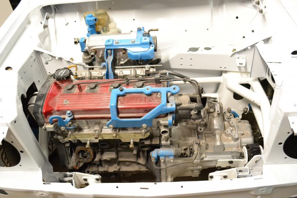

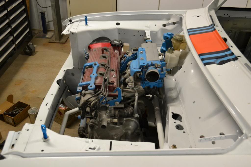

Back to the car - replaced some rusted nuts as per our previous post, and then it was on to the engine install. Proud to say, mission complete - engine installed!!
Its dusty, but its in!! I'll tackle the other engine bay goodies tomorrow.

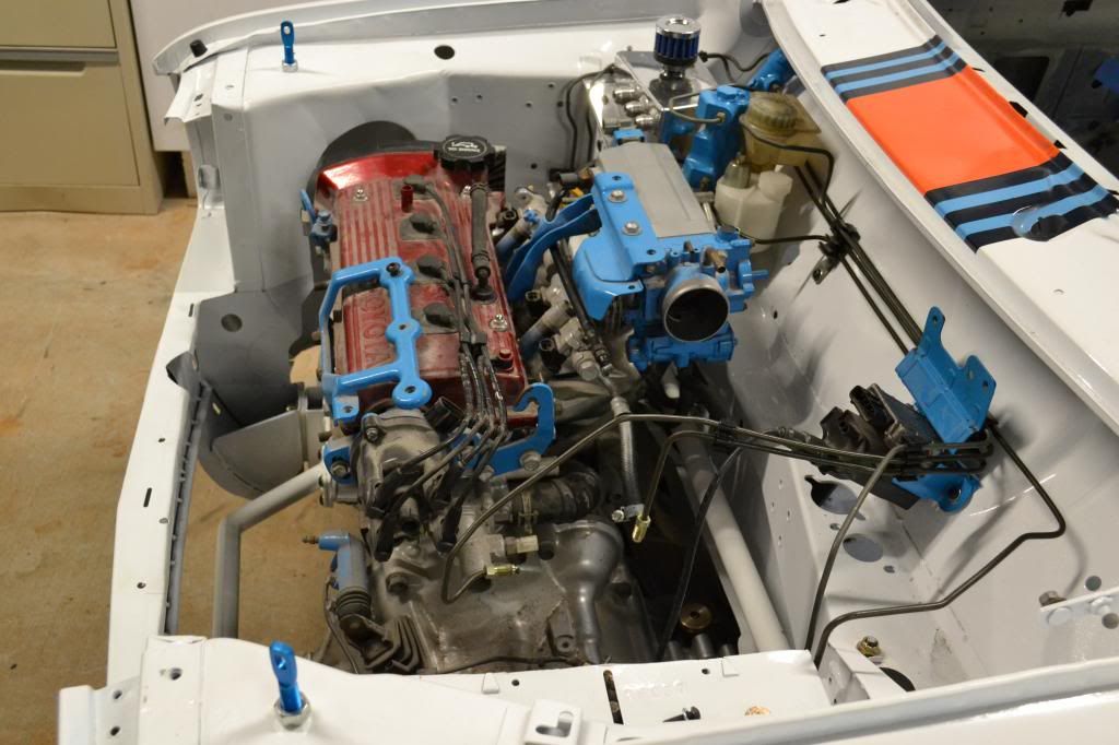

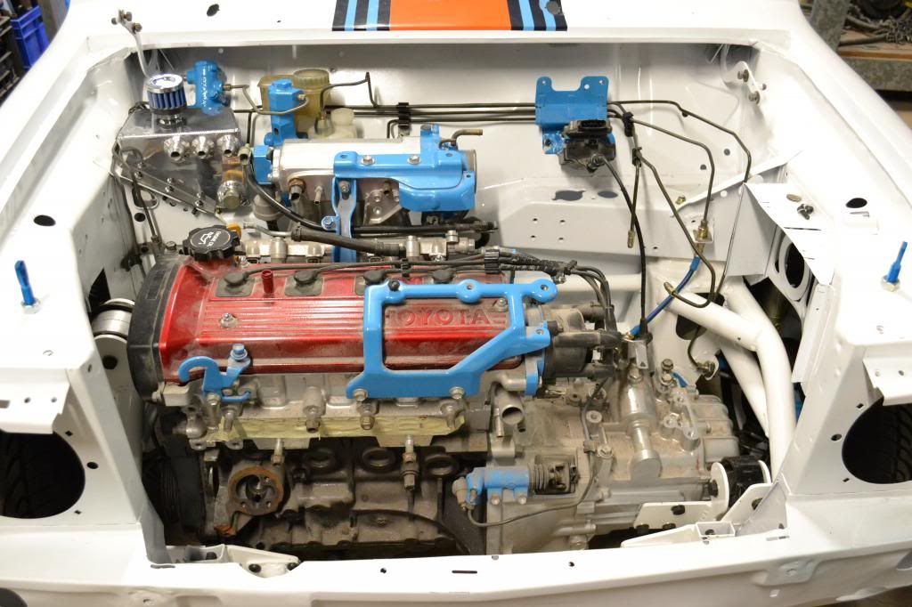

A bit of an update. Spend the day in the engine compartment picking up where we left off. Installed the brake lines, which werent that hard because they were all pre-bent. The hard part was doing the final connections to the different fittings - especially the front brake lines. Also installed the accelerator cable, brake proportioning valve, as it was behind the oil catch-can, and then the oil catch-can itself.
Had to do some serious polishing on the catch-can, as it had many years of fingerprints, grime, dust etc. It can up just fine. Also polished the radiator overflow, but will install that tomorrow as the bracket holding it on needs polishing too. This bracket sits off the mount that holds the coilpack and ignitor, which we installed as well.

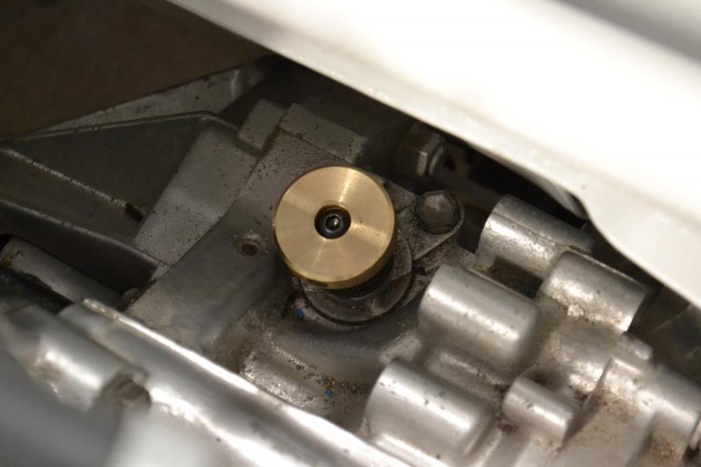

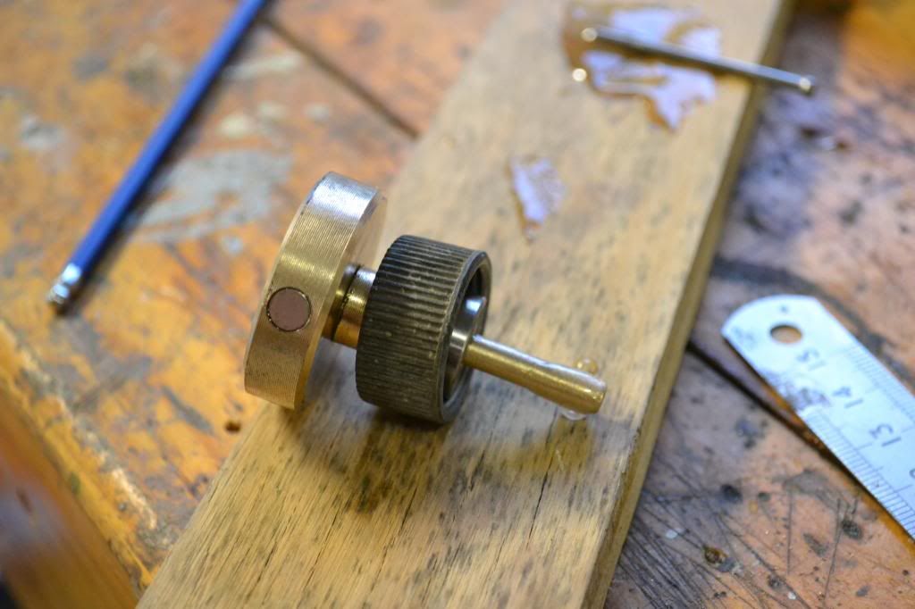

Then I decided to have some fun!! Because I am running a Digidash from ETB Instruments, which has a digital speedo, it uses a Hall effect sensor to pick up magnetic impulses that tell it how fast the vehicle is moving. Now these magnets could be mounted anywhere on anything rotating at the same proportional speed as the car - like a tailshaft or driveshaft.
But, I wanted to do something a bit more engineered and I wanted to use the original speedo cable drive out of the gearbox. So, this would require some thinking and some machining (I love machining!!). This is a job I have put off until the car was going back together, so here it comes.

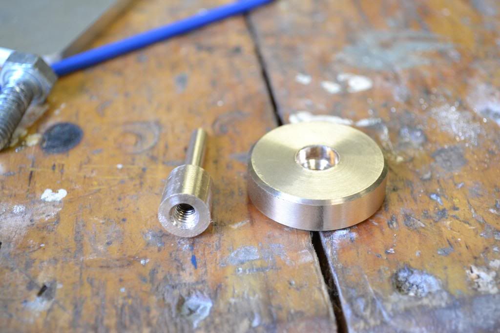

I started off by buying a 16mm x 5mm bearing from BSC - this would form the basis of our speedo drive, as it fitted inside the speedo cable take-off housing. Next was to turn down some metal to make an arbor - luckily I had some brass stock leftover from turning some lamps necks for the wife (why brass, does not rust and non-magnetically conductive). So, I turned down in the lathe some brass to act as an arbor - the dimensions had to be spot on as we wanted an interference fit into the bearing ID, which was 5.0mm, so we turned the brass down the shaft to 5.10mm. The oustide diameter of the body was 12mm, which fits through the screw collar that would normally hold the speedo cable in place. Then we drilled andf tapped a 6mm thread into the body.
Next, we machined a flywheel, which would house the two magnets which give the impulses to the Hall effect sensor - 35mm diameter and with a 6.5mm hole through the center, and countersunk:

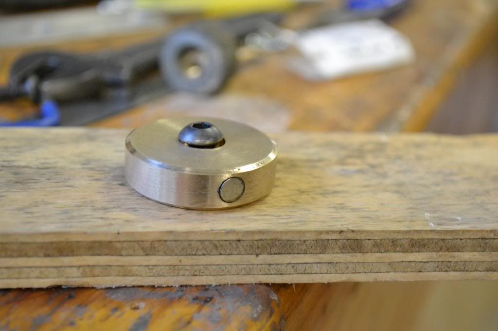

Then we drillled into the outer face of the flywheel 6mm holes for the magnets, and epoxied them in - they must be perfectly 180 degrees apart:
Then we assembled the whole lot together, not forgetting to include to collar into the mix. Press fit the bearing into place, and then Loctited the 6mm socket head bolt through the flywheel and into the arbor:
Then because it was too hard to machine a keyway into the arbor shaft (the original speedo cable has its keyway 'pinched' into it by a special machine), I decided that some epoxy on the end should secure it enough to hold it in place. Remember, it does have to do anything but spin inside the bearing, only having to overcome its own rotational inertia - so hopefully the epoxy will be enough. And then we install it, by simply screwing down the original collar:
Tomorrow we shall make up a bracket for the Hall effect sensor - it must have an airgap not exceding 1.0mm. Luckily the runout on the assembly was only 0.2mm which was acceptable.
