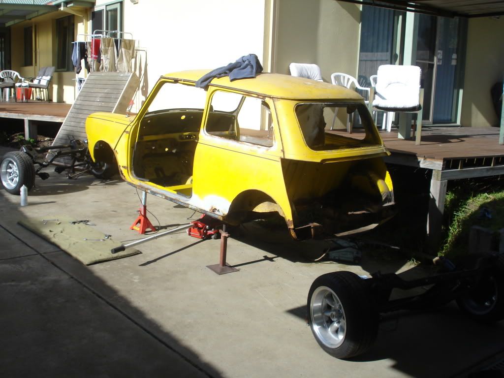

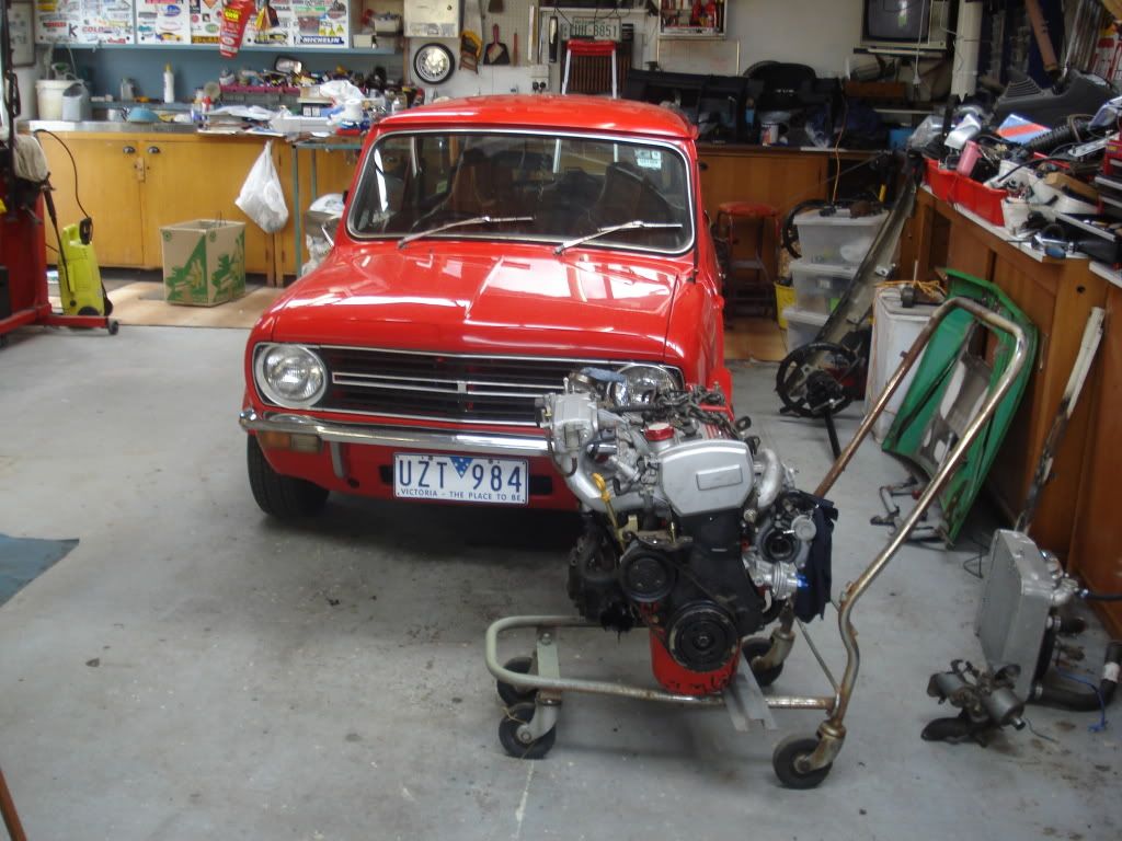

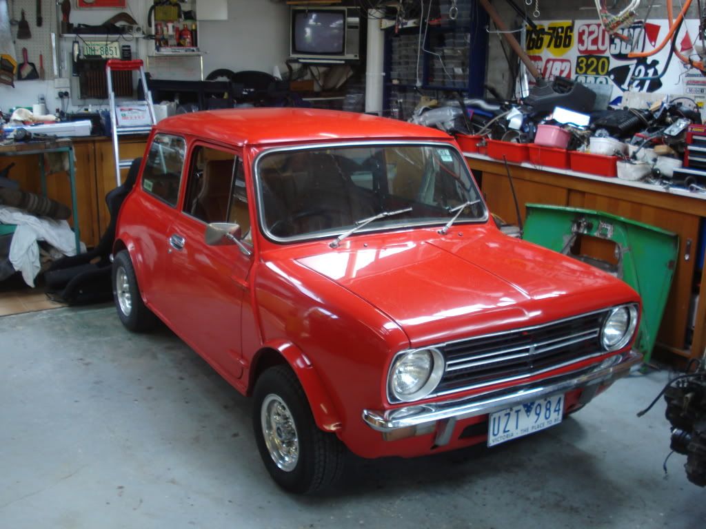

this is how the car looked when the engineer came to look at it

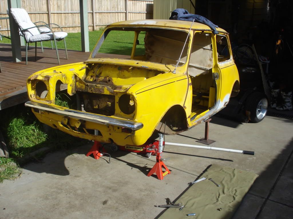

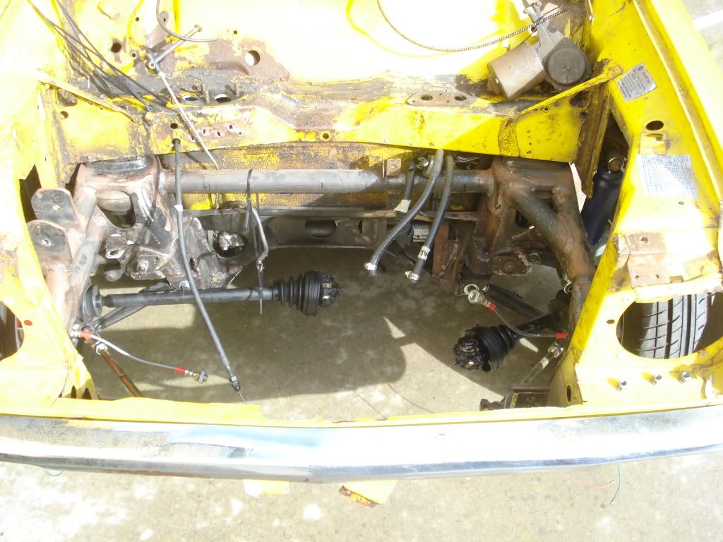

Then it was into stripping the car, first the motor out
Then strip the front and rear ends out
Just the bare shell left and more room in yhe shed

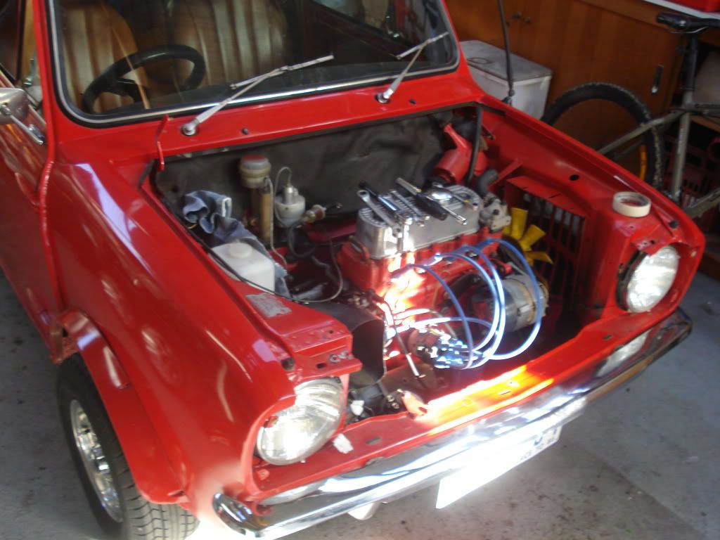

Simply red straight after my last drive with the A series and ready
for the transplant

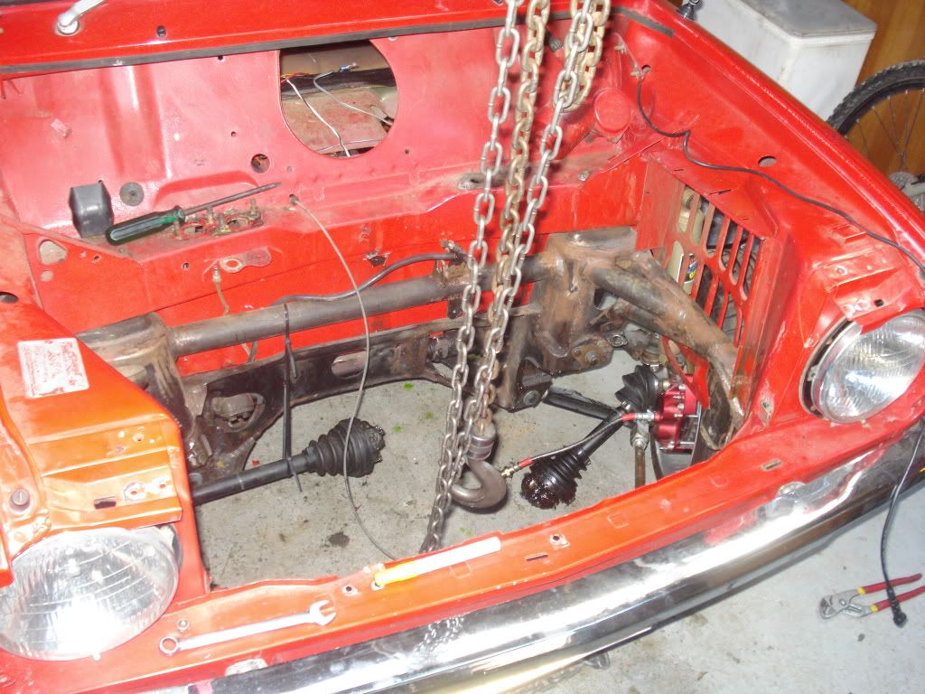

Out with the A series

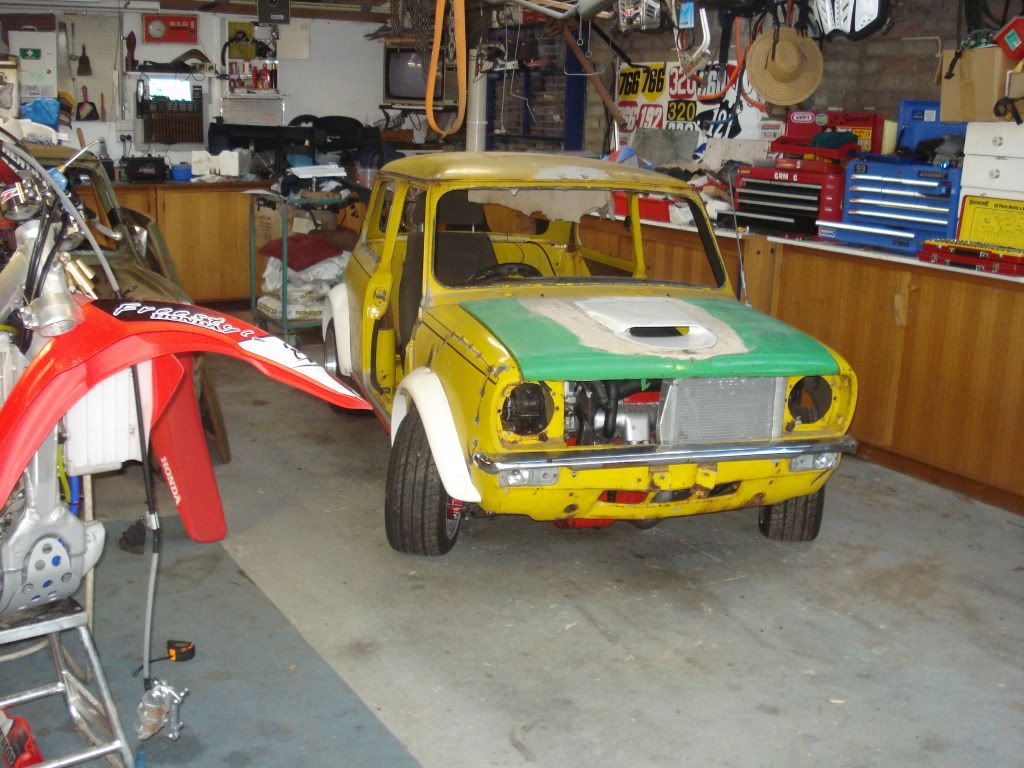

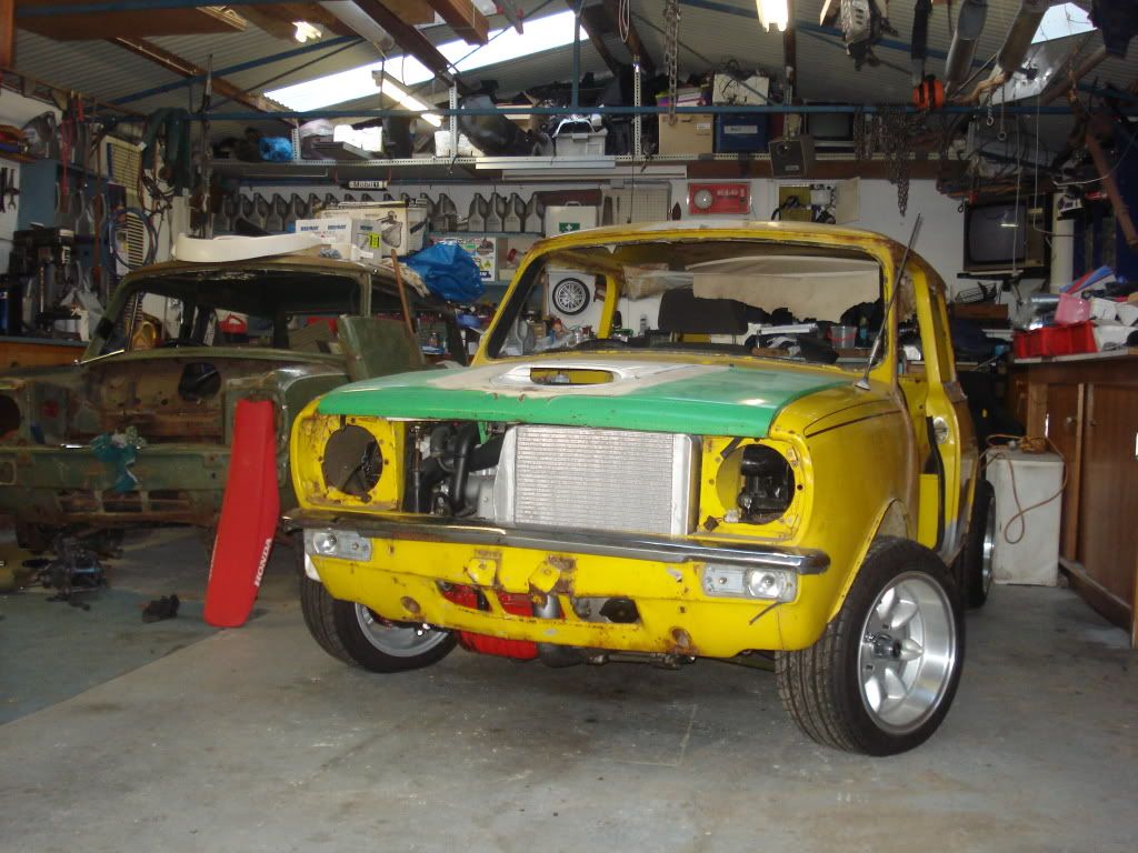

In with the subframe

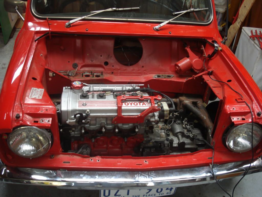

And finally with the 4EFTE
Everything will be test fitted and then pulled out again and painted
when i'm happy with everthing

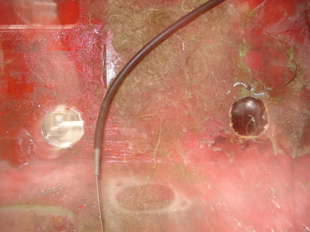

Cut the holes for the shift cables and wiring

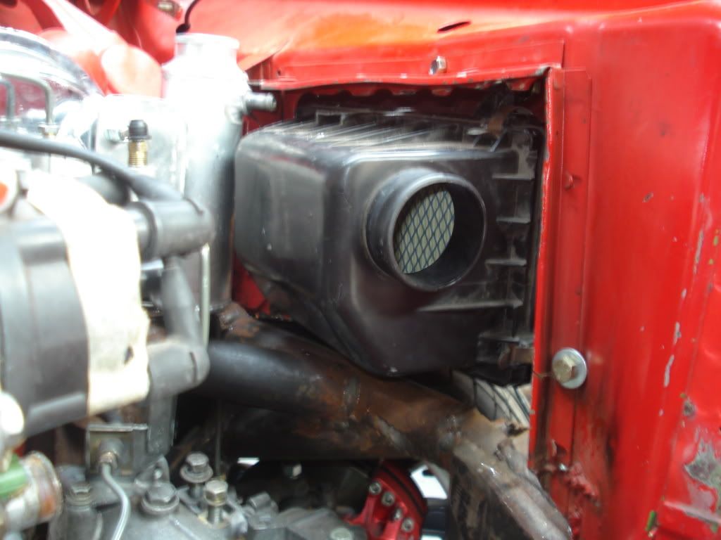

Fitted the airbox

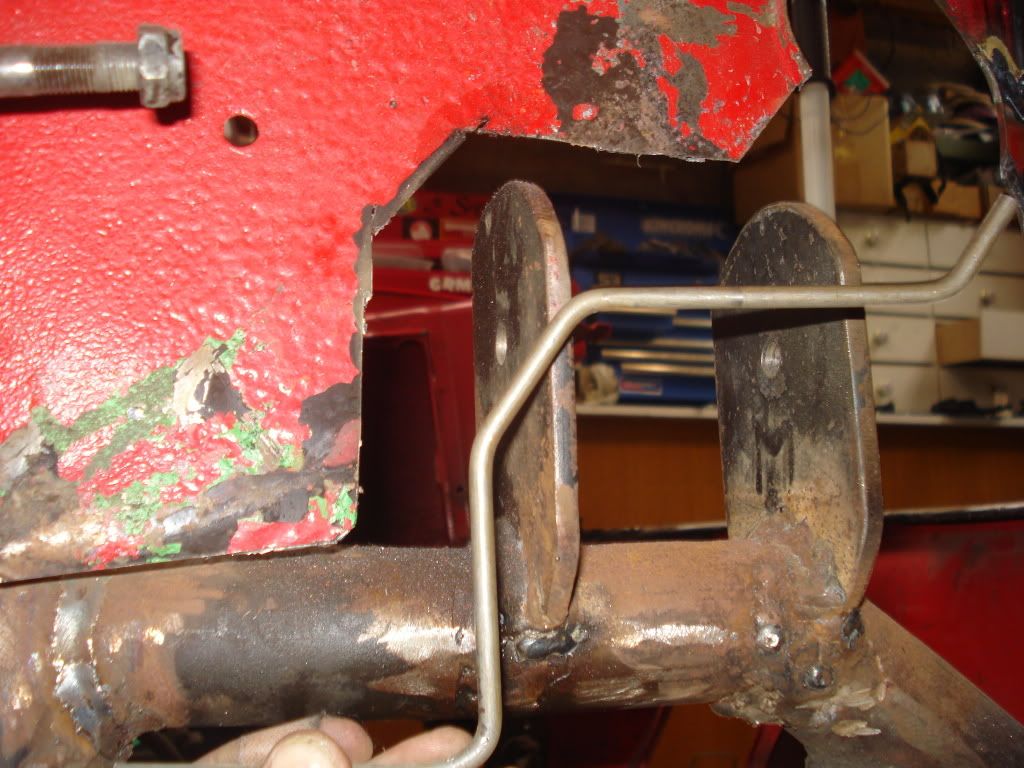

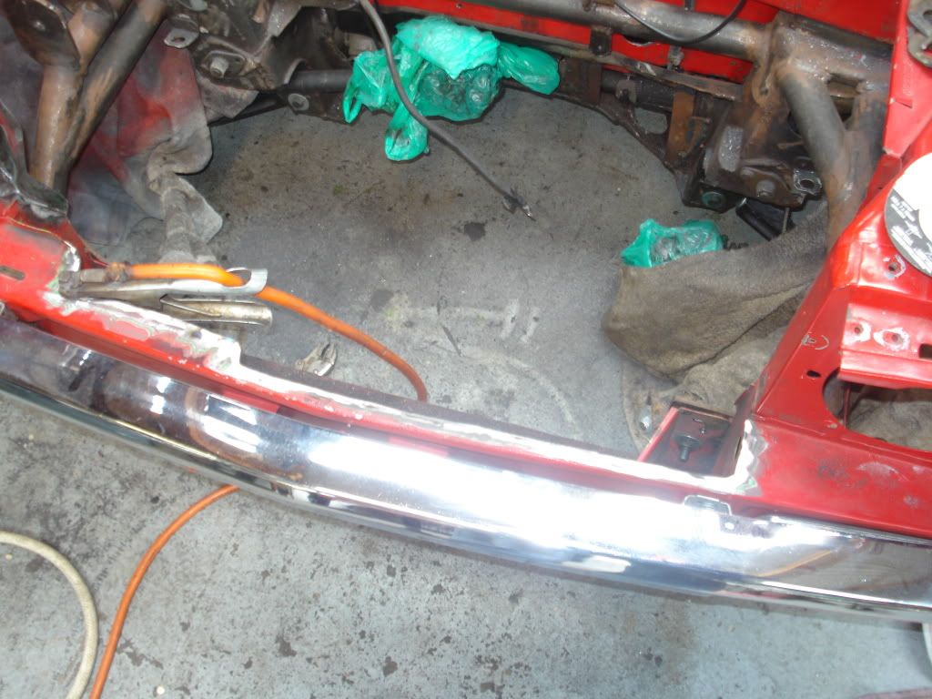

The engineer wanted all the sharp edges gone from when i
cut all the inner gaurds.
So some 6mm rod bent into shape then welded into place
Heres a photo(not a very good one :oops: ) with the rod
in place on the front panel.
This is from the engine bay looking out the front
The same spot from the top. this is the cutout for the radiator
Cheers Hallsey
