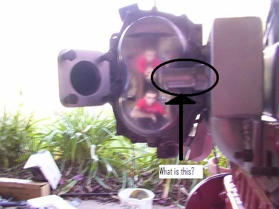

can some one help me i need to know what this part is on the manifold

It looks like the pressure release valve.
This basically is a safety device to stop the mainifold over pressuring and blowing to bits.
Much like a blow off valve in a turbo setup

Yep.... and it is spring loaded.
The only thing that worries me is "releasing" the boost at that location, above the exhaust. Remember, the fuel is already in the system before that point..... so the valve is releasing air AND fuel when it opens up.......

This valve only opens if there is a backfire and venting to atmosphere is OK as when a backfire occurs the fuel in the manifold is already burn (by backfire igniting it) and you get a little flash from valve , if valve is not fitted it will try and turn the supercharger backwards and damage it or the belt. The valve is set to blow off at a higher pressure than normal woking pressure and never opens during normal operation so fuel is not allowed to excape.
