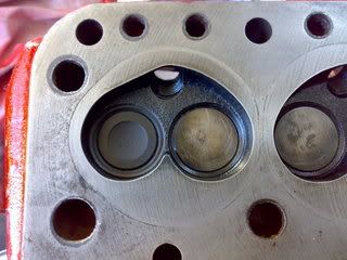

Small head
New head but chambers still need doing :roll:

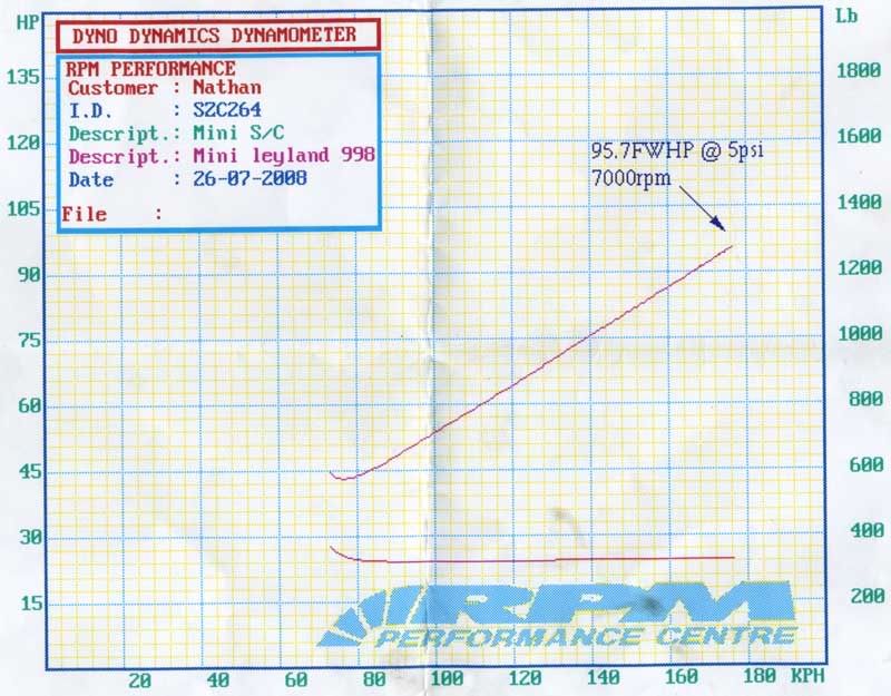

Well i got my car back after 25 ish hours on the dyno and am a happy man, not 100% yet but a 100% better then the SU! 8)
Now shoot me down :roll:
Nathan

That's some good power at the wheels and that power err.. line is bloody straight, even for a supercharger :shock: Good work 8)
PostPosted: Mon Jul 28, 2008 9:38 pm
That's incredible but that read out looks a bit iffy to me :?

Well it’s about time I did an update a lot of things have been happening with my mini. First I don’t necessarily think that the dyno graph was 100% correct, but it was a very linear power from the word go, so I would be inclined to think that it was a very flat torque curve. If it was or wasn’t correct then that’s cool if not doesn’t matter as it’s not on the car anymore and the SC12 carby kit has all been sold now so a fellow Ausmini-er. We learnt lots of little setup things doing it was it was good from that aspect if nothing else. :)

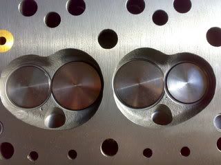

Head is the A+ 12g940 I had that never got put on. It now has been extensively ported and is waiting to build the short block so we can work out how big the chambers need to be. Looks like 27.5-ish cc.
