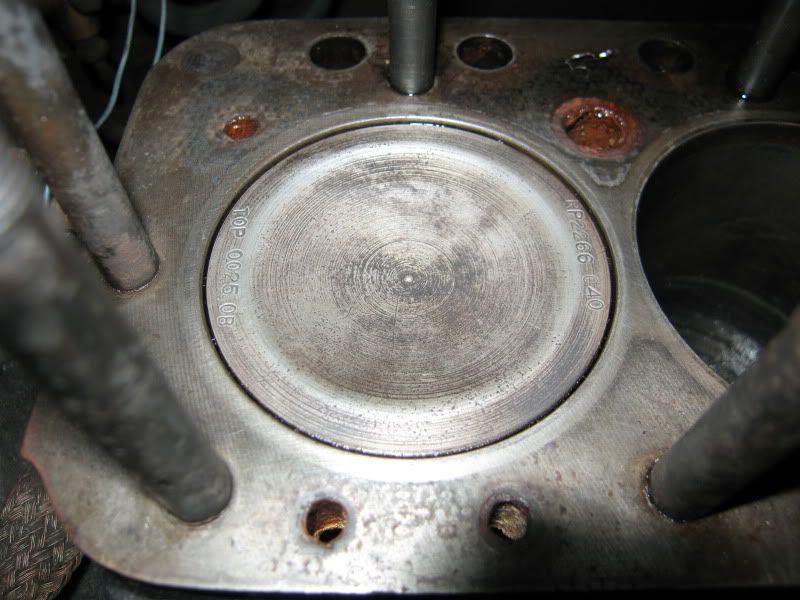

Are these anything special, RP2266 .040
Top 0025 OB
Repco?
Is it me or should 'top' be on the other side, like front?
This is cylinder No 4:
Any good? 8)

yep, repco

Thanks Matt, what about the 'Top' notation?
Can you fit a piston backwards, would it make much difference?
I realise pistons aren't round, but i would have thought the oval was across the pin to help with thrust load?
Hmmmmnnn ?? :?
Sir Alec! we are not worthy!
Hmmmmnnn ?? :?
1275 pistons are symmetrical, 1098s are not- they have the gudgeon pin offset.
Sooooooo, watch which way round for these, but on a 1275 it don't matter.

SuperCooper wrote:
Hows the head look?
simon k wrote:
you're not planning on re-using them though are you?
This is one of my spare 9F/XE/Y Motors, bought condition unknown a while ago, the guy said the head had been 'done up' recently. The bores are good, no lip and the head is indeed a very servicable 12G1805 Mk2 S head.
I'm procrastinating about pulling the head on the original Engine in the Mk2, it blows smoke on start up, and I can see oil on top of the pistons. Hoping its just the head :?
But, once the head is off, who knows ! :shock: :lol:
Short term fix would be to just swap the short motors if the bores turn out to be worn in the S. :x
Then theres the diff, a bit of play there too.....Grrrr Bl#ody Mini's :lol:
8)
PostPosted: Thu Feb 03, 2011 8:53 pm
it's gotta be just the head, but as soon as you do the head up all the fresh compression will mean it'll blow past the rings :lol:
