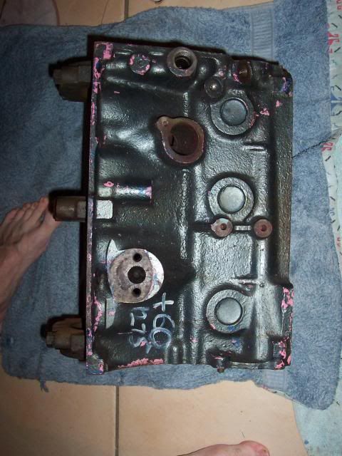

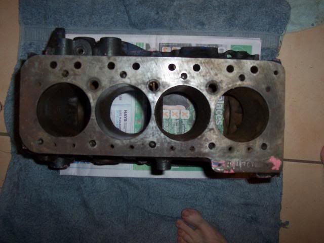

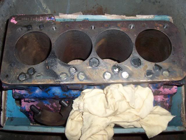

The first issue I want to figure out is the block details (#12YDTaH). This is what I have;
In the 3rd pic you can see at the back of the block behind cyl 4, what is that threaded hole :?:
In the 4th pic what is the threaded hole in the middle of the block :?:
And what is the threaded hole near the edge of the clutch end in the middle :?:
Also in the 4th pic what are all the round sections between the pushrod channels :?: do they lead to oil galleries, can these be drilled and taped into for oil drains :?:
Finally can the dizzy hole be sealed with a welsh plug, what size :?:
PostPosted: Fri Jun 21, 2013 9:53 pm
Posts: 39764
Q1 It's in the oil pickup, there is a brass plug goes in there to seal.
Q2. It's unused on transverse engines, it may be used on a Midget for something like air filter support (maybe).
Q3. Water jacket drain, takes another brass plug.
Q4. Oil drain gallery from rocker gear. Not sure how thick the metal is but could be (carefully) tapped.
Q5. Maybe. Or contact Benjamin on here, he sells a pretty CNC alloy cover for it.
PostPosted: Fri Jun 21, 2013 10:26 pm
Posts: 1479
Location: Qld, Brisbane
Q2. I've been told that was used on the assembly line to hold the block and position for machining. Could be wrong though.
Q5. Yea you can use a plug, just measure the hole and buy a plug and knock it in.

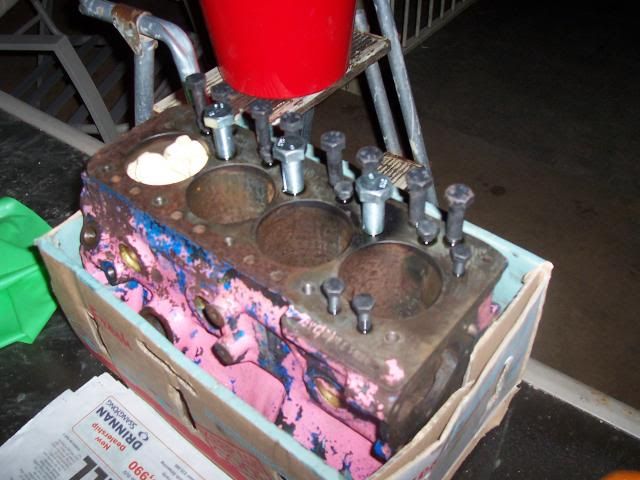

sealed up most of the block deck today, just need to track down some castiron for the two end head studs.
Also degreased and pressure washed the block, three different coats of paint so far plus the factory paint.

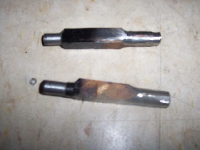

My efforts to find some cast iron rod for the end stud holes hasn't worked out so I looked around the yard and came up with an old cast iron cinema seat frame so my guess is seeing as it's decades old and things were built to last back then it'd be half decent quality steel.
So I began to cut it down and spin it up and this is what I've ended up so far;
not the best pic.
The "machined" ends are 9.5mm and 10.5mm so once I get it in a real lathe hopefully I'll have something I can use :) .

Cut off the bolts, but still need to finish the cast iron studs which should hopefully be tomorrow.
PostPosted: Thu Jun 27, 2013 6:28 pm
Posts: 1170
what sealant/thread locker did you use for this?
Grant
100% Pure A Series Turbo
PostPosted: Thu Jun 27, 2013 9:20 pm
I forget exactly. It's a type of component sealer and it's green.
My brother is a mechanic (15 years) and he said it will do the job so fingers crossed :lol: .
