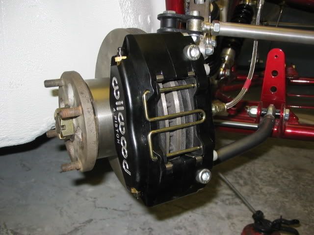

im going to be using Metro Turbo Vented Brake conversion kit on the rear with 4 pot calpiers and adapted for the handbrake, adjustable lower arms on the top and bottom of the upright plus some coilover shocks. Up front will be the 4 pots supplied by zcars since im using their front subframe kit

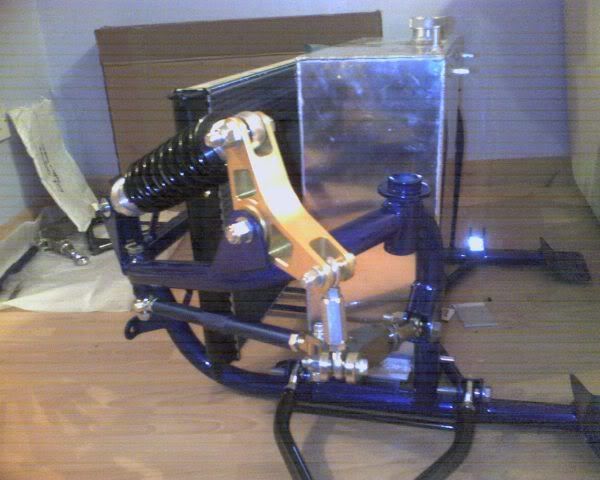

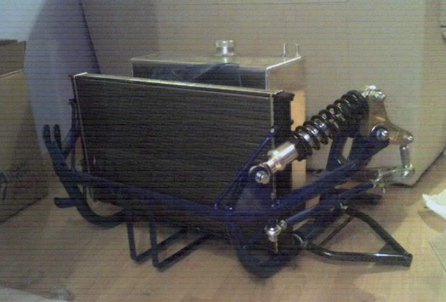

hahaha well im hoping it to be round $2500, anything less would be a bonus. Im going to ring them up on monday so if anyone wants to get one too pm me and ill ask for combined shipping. For people who are unsure what it looks like:
Also i nicked this from my proposal to the engineer explaing what it was
The tubular front subframe from z-cars (Figure 1.1) is designed to eliminate bump steer. It is 10kg lighter than the original Mini front subframe and includes mounting points for the radiator and aluminum fuel tank (Figure 1.2). Included are inboard aluminum rose jointed adjustable shock absorbers which are operated by pushrod lever from the wishbones. Double wishbones again rose jointed and adjustable for caster and camber by means of left and right hand thread rose joints and connectors. The whole kit is powder coated and nickel plated on the metal parts. Also the kit fits the original mounting points at the top for the subframe and down near the driver and passengers feet. Instead of the original 2 bolt fixing, the subframe has a 10 bolt fixing adding to the stiffness of the subframe. It has an integral pedal adaptor (Figure 1.3) for the accelerator to enable the mounting of a straight throttle cable under the car from front to back and then pulling on the original cable through the bulkhead using he original Mini pedal. Under the radiator at the front is room for a dry cell battery to be fitted.
