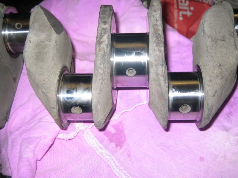

Welll finally all the crank issues are over, well almost all. When the crank was sent to Spiro for grinding, he noticed that one of the big end journals had picked up a bearing at some stage and picked up metal that had welded itself to one of the crossdrill holes :?
Anyway Graham managed to drill it out and balance the crank. He is undecided about whether we should replug the hole or not with a new plug... he says it is unecessary for what I am doing with it (road car). We will decide this later...
The other thing "wrong" with the crank is one of the counterweights has been severely angled off with a big grinder. This was "factory" balancing. They didn't have time to worry about making cranks look nice, they just took to them with a huge grinder and took out what they needed to in one pass :shock: Subsequently there is ALOT taken out of one of the counterweights. Graham has managed to balance the crank and there was not much needed to be taken off the crank to blance the entire crank. Graham says although the counterweight grinding is not ideal, it is ok for what I am doing (road car). If it were a full race car he would build the counterweight with weld and grind it back and balance again.
All in all I am happy with the results of the crank. It does look very good.

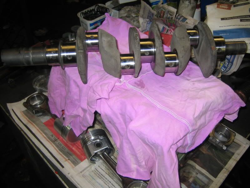

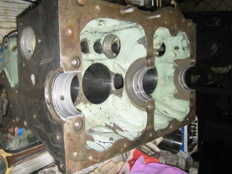

I started by scrubbing the insides of the block including oilways. I used Graham's long handled brush and got all the dirt out of the oilways, bearing feed oilways, main galleries and the block, crank and rods and making sure it was entirely spotless. I then ran them through 15 mins on the hot washer. They all came out spotless.
All clean and ready for assembly
The new uncracked, ground and balanced crank. Note that the dull finish is due to acid dipping and hot washing.
The cleaned block

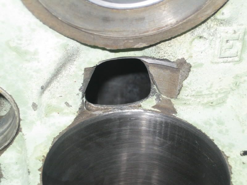

Note that I have an older 1100S block, you can tell because it has a gaping hole in between 2 and 3. This was removed in later 1100S or so called GT blocks. Graham ground around the hole so that there are no sharp edges or burrs.

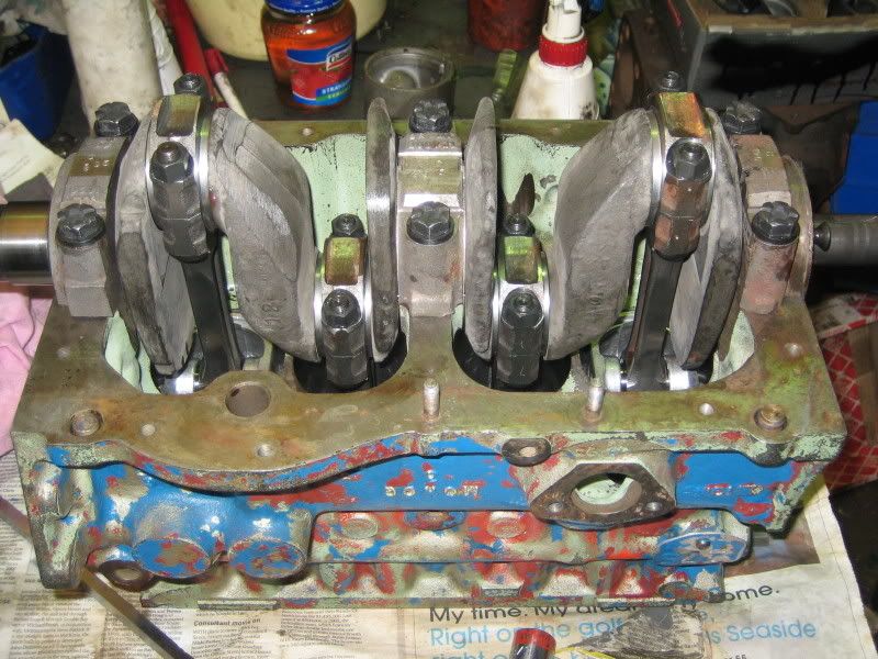

I then began to assemble the crank and rods with the new Duraglide bearings. I used bearing saver assembly lube on both the bearing surface and the journal surfaces. Graham reminded me to use LMM grease on the threads and under the heads so that they would torque down properly.
Graham then warned me that the bolts may bottom out at full torque, in particular the centre main bolts. He must be a psychic because sure enough the bolts were bottoming out! the hole is deep enough but the thread bottomed out. There are really 3 options, tap it deeper, cut the bolts shorter or use hardenned washers to space the bolt enough so that it doesn't bottom out. Graham just happened to have a stash of ARP hardenned washers (as you would :lol: ) and all was sweet.
